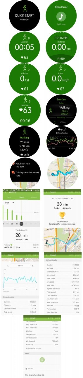

I've been using the S2 Classic since October 2nd. I try to get an hour in of walking daily. I've been very pleased with the fitness tracking.
I will try to give you an idea of how it works on the S2 for my walks. I have a widget set up that I can manually start tracking my walk real easily with just a turn and a screen press. Once walking the watch will track and show my distance, heart rate, speed, etc (any of the green screens in the image I linked). I just turn the bezel to switch the screens for the one I want. Once I finish walking I hit "finish" and then a summary is logged in the S-health app on my watch and on the phone. On the watch the summary shows what my heart rate was, a map of where I went, speed, etc. Even more detailed information is available on the phone app.
Screenshots off my watch and phone:
http://s13.postimg.org/sk005u90n/Final.jpg
Wow thanks. I'm looking into getting the 3G model as well. Does this app require the use of the phone? Are you happy with these results?
