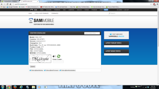

Yes it was a stock firmware specifically for AT&T but it will not flash.
Yeah, it says MDL is the latest but I'm pretty sure it's MF3.
Do you know anywhere else I can get a copy of it? I'm not being lazy. Trust me, I've spent a lot of time researching this issue.
Oh sorry. I didn't see that! However, it seems when entering my device, there isn't an option for the US at all!
You need to search for your model. The search box is near the top, just put SGH- and whatever the AT&T variant is
Yeah, haha I did that. There are no US carriers available on there. All other countries for my i9505.
