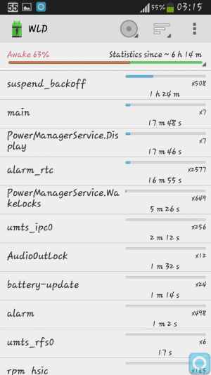

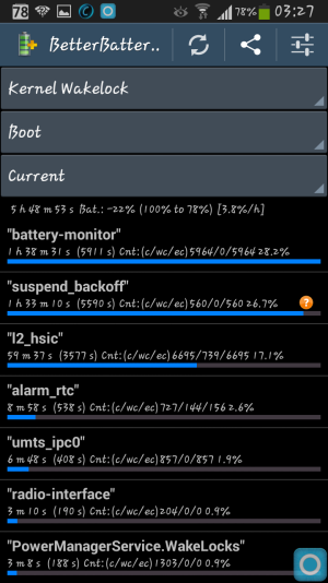

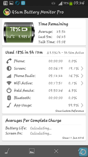

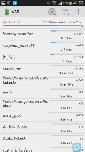

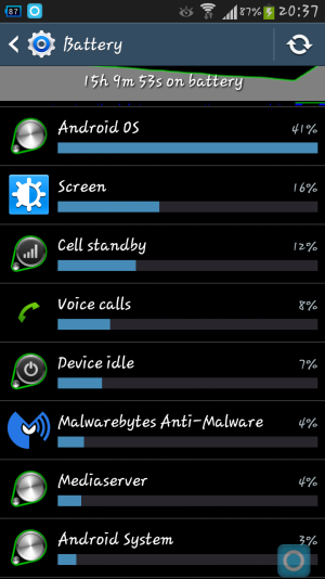

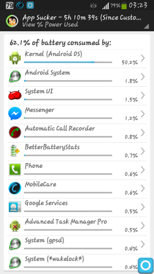

Galaxy Note 2 - Massive battery drain after 4.3 update

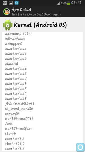

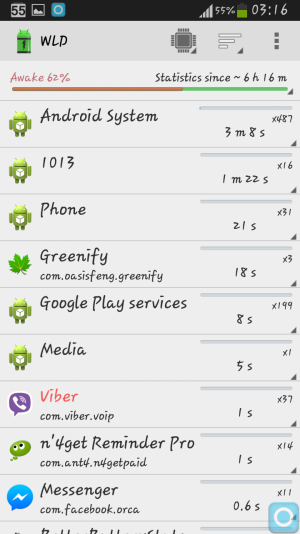

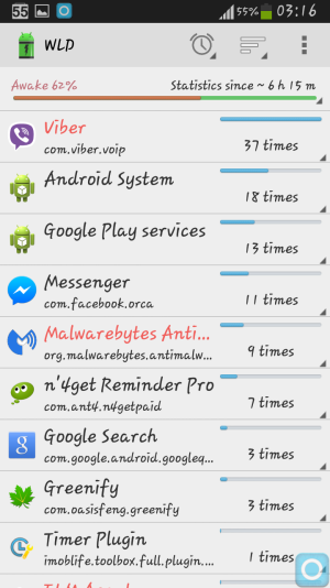

Screenshot_2014-01-11-20-37-31.pngScreenshot_2014-01-11-20-37-51.pngScreenshot_2014-01-12-03-23-25.pngScreenshot_2014-01-12-03-23-42.pngScreenshot_2014-01-12-03-24-41.pngScreenshot_2014-01-12-03-27-12.pngScreenshot_2014-01-16-06-36-22.png I have included here some photos from different battery monitor and wakelock apps (I hope they upload!) Maybe they could help.

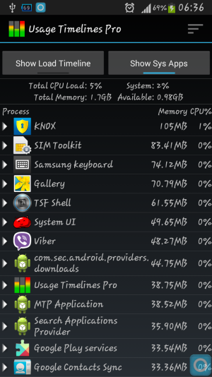

A few of us here don't seem to be facing this issue but I have confirmed that KNOX is eating a lot of my cell RAM + CPU. It has to go from my cell!!

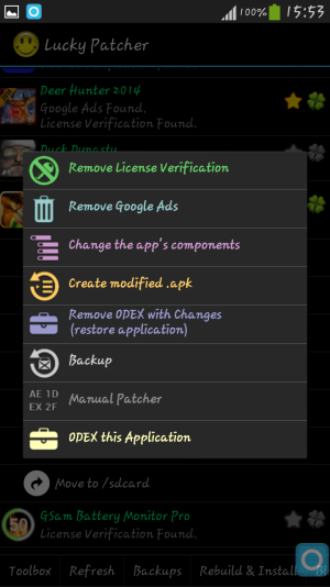

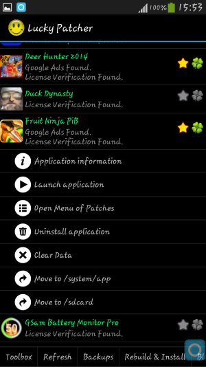

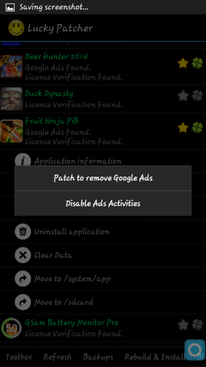

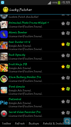

After you remove all the Knox bloatware and anything else you don't like, install Lucky Patcher (Google it).
This is usually used to remove licenses from pirated apps, But it also does something else which we will need to use:
It removes Google ads! And these are that keep our phones awake.
In the faulty 4.3 Samsung update apps with Google Ads always try to connect and sync thus keeping the phone awake.

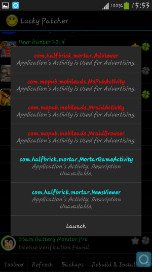

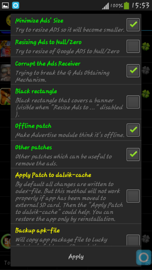

In Luvky Patcher go into each app individually and choose "Remove Google ads".
Then choose "Patch to remove Google ads" and press "Apply". Rarely will you have 100% success but it doesn't matter.
Then repeat the process and this time press "Disable Ads Activities" and press each activity that is used for advertising (They are usually in orange colour).

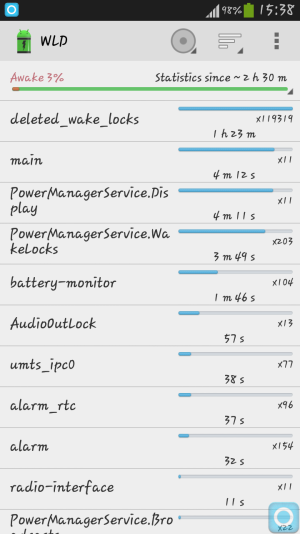

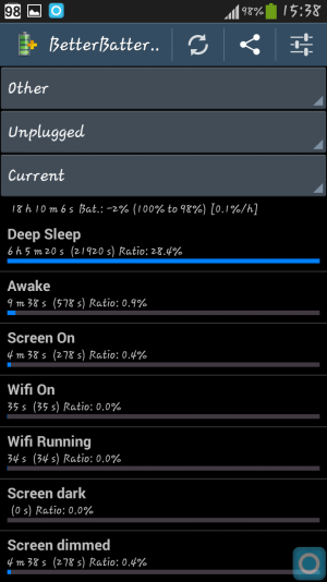

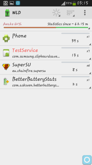

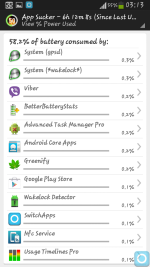

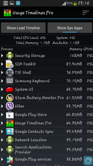

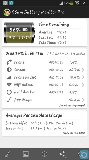

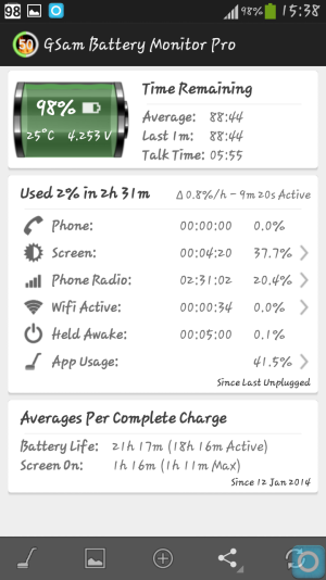

It is time consuming but it's worth it. Now have a look at the screenshots I uploaded.
They show only 3% wakelock instead of the 65-85% that was before and the battery only went down to 98% from 100% in 2.5 hours!
My battery life now is better than on 4.1.2! I hope it stays that way. So go ahead and try it for yourselves.Screenshot_2014-01-18-15-38-17.pngScreenshot_2014-01-18-15-38-32.pngScreenshot_2014-01-18-15-38-52.pngScreenshot_2014-01-18-15-53-12.pngScreenshot_2014-01-18-15-53-23.pngScreenshot_2014-01-18-15-53-28.pngScreenshot_2014-01-18-15-53-33.pngScreenshot_2014-01-18-15-53-39.pngScreenshot_2014-01-18-15-53-52.png

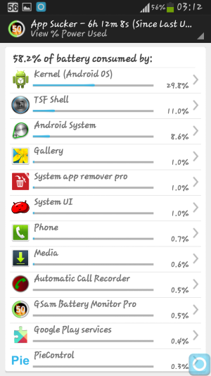

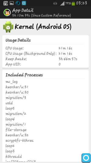

Update. The phone had an excellent battery life for about three hours. I then made a couple of phone calls and the drain started again. About 64% awake time. As usual Android OS was the culprit. It seems that this Samsung 4.3 update is so messed up that nothing can save it. I will have to decide if I'm going to carry a spear battery with me or downgrade to 4.1.2. Can anyone give me detailed instructions how to downgrade?
