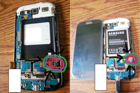

Hi all!!
Sorry but I am just here to describe the solution for you if your galaxy s3 touch screen is not working which I already suffer and [Thanks to Allah] I've solved it.
First thing First let me describe my problem.
I had no problem with my Galaxy s3 except touch screen. As you understand, every thing was good except even not being able to answer my calls.
After reading several forms, I decided that problem was about hardware not software so I decided to open my galaxy s3
After I opened it, I saw a cable which comes from right top to right bottom and which was unpluged so I plugged it then my touch screen started to work.
I plugged in which emphasized with red, purple, green and black.
Tags: Galaxy s3 touch screen not working, galaxy s3 touch not working, samsung s3 touch not working
Why this came to me?
Maybe the reason is my magnet which is tested with my s3 by me
Maybe the cable was un-pluged because of this magnet
Thank you all!!!
Welcome to the forums! And thanks for contributing.
Strange - the cable that you seem to be highlighting is one of the antennas.
