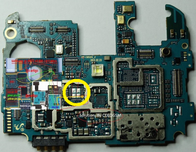

I found the service, which is carried out repairs motherboard in the range of error which is discussed here. Total cost of replacement chip (reportedly it is usually damaged) is 150 PLN (~ 35 euros).
The guy from the service said that the problem lately intensified and an increasing number of these notifications.

This really is a design flaw, although I doubt that it's any kind of planned obsolescence. Of course it's not wise to state that a single fix will solve everyone's issue, but certainly my experience is that the inner foam reinforcement is the way to go in most cases. The key to this is to not do this just inside the case backing but remove the inner bezel as was suggested previously in this thread. The other important thing is adequate foam thickness. A minimum of 1/16th" is required. In my case and the others I've done, I used 2 layers of 3M heavy duty adhesive tape (red) cut to the exact size of the top of the on board sim card cable plug. A simple test is, that when you re-install the inner bezel it should actually bow up a little. Replacement of the 9 screws will bring it down. Also be careful when you remove the bevel. I haven't seen it but I've heard they can break. I've done my own and a dozen others and every unit is weeks into functionality with no sign of the dreaded message.

You're right it should be covered. But it's not a software problem. It's a hardware issue. The foam fix seems to do the trick on every unit I've seen.

Here's my two cents. I would go with the flow here and say it's shotty solder work from the factory. I read somewhere else they used a cheaper alloy solder on these boards, and if correct, over time with the heating and cooling, some joints will crack. I experience the problem about once a day, only if I do this. This time of year is cold here, below freezing, so when I get to work I go to my work truck, put my phone and stuff on the doghouse (dash) and start it to let it warm up. When I come back, 9 times out of 10 I have to do the restart. With the cold, metal contracts and any cracked joints are left making an even larger cracked joint, leaving it more of a chance it's unable to make a connection. When truck is up to temp. the solder/metal would expand back to a normal state to more solid connection and all is good. If I leave my phone in my pocket, I do not get this. For others that get this more often, it could be due to a more severe cracked joint or multiple cracked joints, and vice versa. Because of the cheap alloy solder used on these could be a reason why the problems re-occurs even a rehot/reflow, unless new solder is applied, which would be very very difficult to do on the small components.
With your issue being so temperature sensitive, a cold solder joint does seem to make sense. Speaking for myself and the few phones I've done, ambient temperatures don't seem to play a role, albeit operating temperature may or may not be part of the catalyst. In your particular case, which seems to be the exception not the rule, your diagnosis seems flawless to me.
