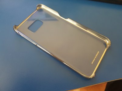

Can it be because of a back case? Maybe the case is "pressing" the phone? I've reflashed it with Samsung Kies Recovery, removed my back case, and no issue for 1h straight playback....

OMG. I think the case was the issue... wTF

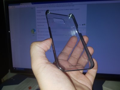

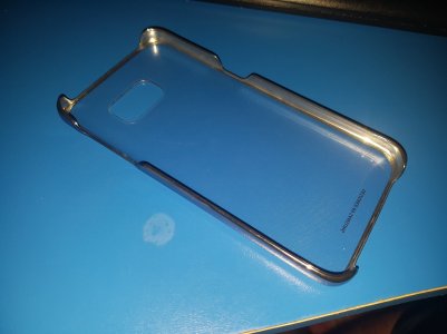

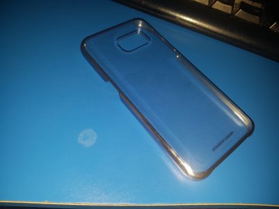

If the case is the problem, I hope samsung gives me an award :). I will take a photo of my case.

2. Removed my back case ( it was an "designed by samsung" hard case, putting a lot of force on the phone ).
