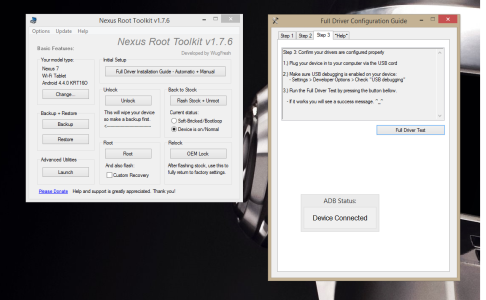

Hey! I'm trying to revert from cyanogenmod to stock android and I'm running into what seems to be a driver issue.
I will got through the steps I've done to better explain.
1. Followed Nexus Root Tool Kit driver instructions.
2. Do driver test.
3. ADB passes

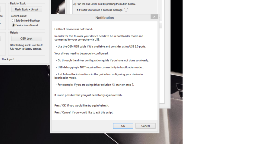

4. Fastboot fails

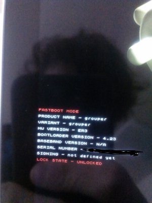

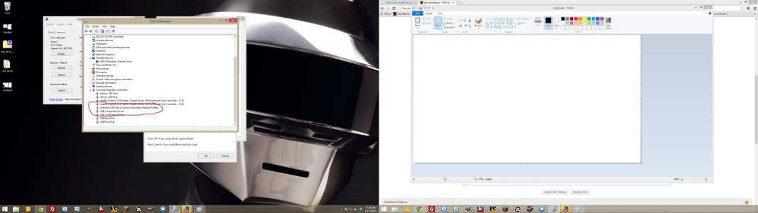

Every time I go into my bootloader my computer says as follows
USB Device Unknown(A request for the USB device descriptor failed.)

To the OP. I wrote a guide to manually install KitKat on Nexus 7 and added the Google USB drivers I needed to modify in order to user ABD/Fastboot on Windows 8.1 x64. You can try to use those drivers and see if they work with your Nexus 7 model.
If you open the android_winusb.inf file you will find a label called ;custom that I wrote to find my added lines (two lines in my case). See if that matches the Device ID in Windows Device Manager. If it doesn't you can try to add the one you are seeing when you right click your tablet and select Properties - Details.
