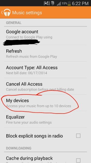

The only thing I can think of is to check the my devices list (see below). If you have to many it won't let you add more to do syncs for music and such.

I removed two of the four devices I had connected with google music, restarted my device, no avail.
I've checked the list of devices, I'm within the limit and even cleaned up a couple of old ones which were there. Still nothing.

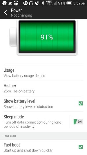

This is my settings...power menu. Which one is extreme power?

I'm pretty sure the ultra power save is only for the M8... He said he had the M7. I know the M7 got the new sense but I don't think the power save went over.. Could be wrong though.
Sent from my T-Mobile Note 3 using AC Forums.
I've got the M7 and it's on mine since I updated to Sense 6?
