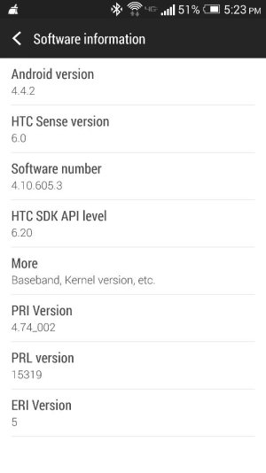

Maybe it's a Verizon limitation. I do have Sense 6

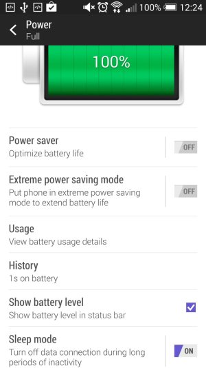

I don't use Extreme Power Saving Mode on my M7, but turning it on and then off fixed the problem. :) Very strange.

I toggled the extreme power saver on and off and everything seems to be pinning to my device again.

I have the HTC One M8. I was able to fix this just by enabling "Power Saver". Settings -> Battery Manager -> Power Saver (turn it on).
Music started downloading immediately. I think this is a bug in the software.
The "Power settings" worked for me, thank you so much. Google said it was an HTC issue and wouldn't help when I called. Great advice!!
