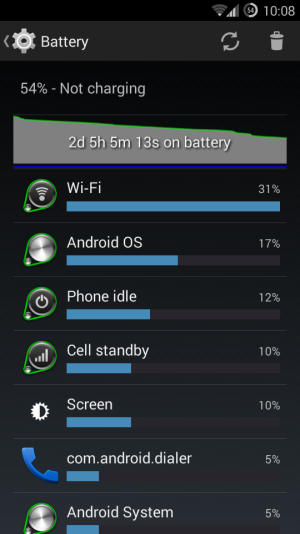

I've been running a build I did on 1/22 with recent kernel updates by Stargo and check out this battery life. No deep sleep issues here. :) I'll probably have some new builds mid day tomorrow for you guys.
Did you use your phone at all? I've never seen battery life that good and I hardly have anything syncing and don't use my phone much during the day.
Sent from my XT908 using Tapatalk
Used it a little bit, my normal use. I was lucky to maybe get 30 hours before using it the same amount. This is pretty much the same as I get running the stock rom.
