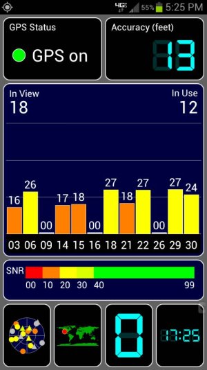

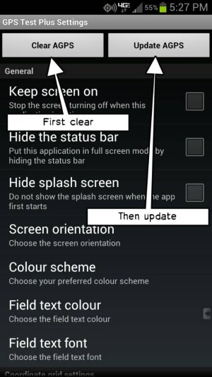

It should look something like this:uploadfromtaptalk1350693526013.jpgIf it doesn't, press Menu -> Settings and select the two buttons at the top:uploadfromtaptalk1350693650053.jpg

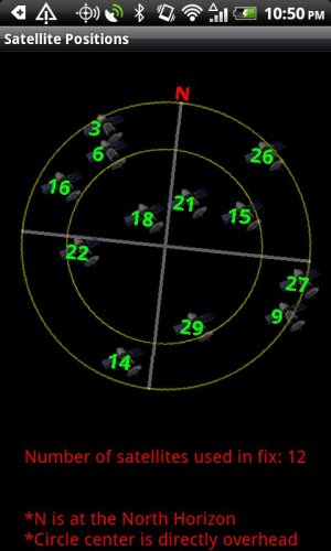

Could be the app you are using is over-filtering the signal. Try downloading the free app, Polaris Navigation System, and make sure you have a view of the sky. The app reports your position and does tracking and has a satellite report which will tell you how many satellites are available to you and and their positions relative to your location. Try running it concurrently on one of your friend's Galaxy S3 devices from the same location. The two devices should yield the same report from the satellite screens. If they don't, try waking up a "hibernating" gps chip by restarting your phone. Here's a typical satellite report and a link to the app:

The GPS will work 100% stand alone with no data. (you will need maps in memory for it to be useful of course)
But, if the GPS has been unused for a LONG time, it may take a long time to find the satellites and catalog them. If you have a data connection, it can download info on satellites online to help find them quicker. Once they are found, the data connection is not needed for days. And not really needed at all, it just make it quick if your satellite data is stale.
Then of course there is the location services that use WiFi or cell towers to help locate you. These are not GPS and have nothing to do with GPS and are not very accurate. But they are good enough for looking up your location for the weather or such, and use low power.
