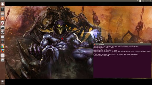

and then:
Code:
sudo apt-get install android-tools-fastboot
Each time you enter the 'sudo' command, you may be prompted for your password. On Ubuntu, it's the first time and it's automatically assumed until the window is closed. I believe there is a time interval if left idle.
After each entry, the PC will download the proper files. This usually goes pretty quick, the files needed in this case are quite small. You may have to confirm the installation by typing Y or yes and pressing enter.

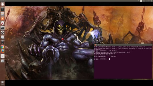

Once all that is set up, you can do a test. Plug your device into your PC. Before doing the terminal commands, pull the notification shade down on the device. You should see a notification for USB. Click on it. This should bring up options as to allow the device to just charge or do file transfers. Depending on the device setup, you may need to do nothing.
After that change is done, you can go back to your terminal window.
Type in:
Code:
adb devices
This should bring up the serial number of the device and say device. Once you have this result, you can start using adb commands to your device.

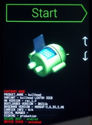

Getting into the bootloader differs from phone to phone, but most commonly it is a combination of holding down several keys at once. For a Nexus phone, that means holding the 'volume down' button as you power on the phone. Now, some custom ROMs include the option to reboot into the bootloader when you hold down the power button, but if you are on a custom recovery, I assume that this guide is no longer needed. :) But if you boot into the bootloader, you will see something similar to this (again, this is a Nexus phone, other phones will have a different screen):
Your mileage may vary... This is the bootloader menu on a Nexus 5X and will be consistent with other Nexus devices. Other OEMs use fastboot now (Moto, LG somewhat recently) but their landing screen will be different. But in any case, once you are here, you will run fastboot commands in a command window on an attached computer, very similar to how you can ADB commands. They are structured mostly as such:

Most phones come with a locked bootloader, meaning that there are protections blocking you from flashing system software unless you have a OEM-approved tool to do so. Some phones come out of the box with a locked bootloader but allow you to unlock it... Nexus devices don't need any special handling, but other phones require you to enter in a special code to allow you to unlock the bootloader. I won't go into detail on those because they vary from OEM to OEM and phone to phone. For a newer Nexus device, the unlock command changed, from "fastboot oem unlock" to "fastboot flashing unlock". But the command accomplishes the same task, first, your phone is completely wiped (as if you factory reset) and the bootloader is then unlocked. Subsequent reboots will pop a kind of ominous warning that your phone is now unlocked and can't be checked for consistancy, yadda yadda...
As you can see in the screenshot above, the device state shows as "UNLOCKED", so I've already unlocked the bootloader. Now, on your devices, there may be warranty concerns. Some phones have software fuses that will permanently report that you've unlocked your phone and others even have a flash counter to flag your phone as one that has been modified. Check on your particular model before proceeding.
