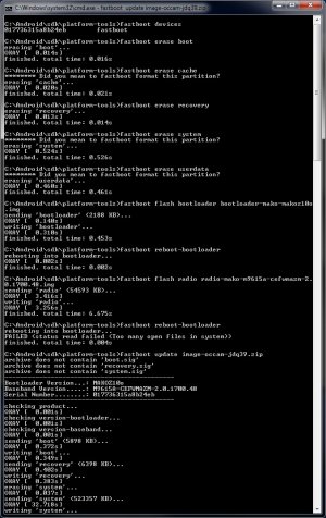

Everything works fine until i try to send the image, it sends properly but stops when it is writing 'system'. I have also tried re-downloading the Image, different Usb ports, have also tried Wugs Toolkit and the same error happens.Untitled.jpg
