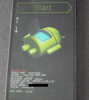

3. You will see the Android logo laying on his back with his chest panel open, along with the device info and options.
The home screen for rebooting into recovery.

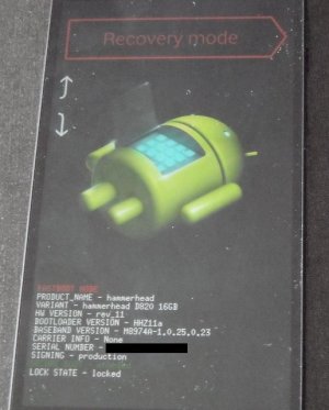

4. Use the Volume rockers to navigate to Recovery Mode

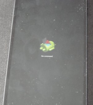

5. Once there, you will see No Command. Press and hold Power and click volume up like you want your music to go up one increment.

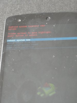

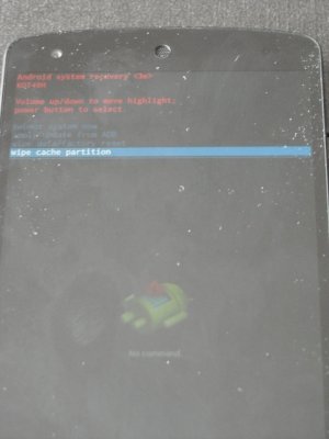

7. Use the volume Rockers to navigate to what you would like to do, and power accepts the selection. Use the rockers to go to 'Clear Cache Partition'.
Click Power to accept.
8. To reboot, click reboot system now.

1) Your text says "Use the rockers to go to 'Clear Cache Partition'." Yet the photo shows "wipe cache partition". Might seem like a minor difference, but technical documentation shouldn't include discrepancies like that.
2) After I select "wipe cache partition" and click Start then I immediately see "erasing" in the middle of the screen (under the robot). And the lower-left corner has:
-- Wiping cache...
Formatting /cache...
The above seems like a step 7.5 that maybe you could include in your helpful post?
It took nearly 20 minutes for my N5 to get "cache wipe complete" (and thus go from step 7 to step 8).
