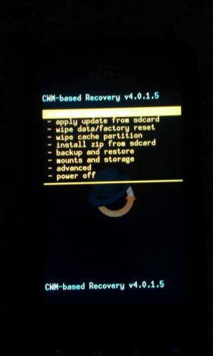

View attachment 96880 im stuck on CMW based recovery v4.0.1.5 cant find a way to get out of this screen for months, better to toss phone?
Install the xionia recovery from Andys post above and find the fix recovery loop option and reboot. You should boot into your rom at this point if not you'll either have to restore a backup you made previously or if you don't have one you'll be able to flash a new rom with xionia
