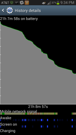

It was like the second I took my phone off the charger, it went down hill fast. Today I haven't gotten great battery, just about 9 hours, but I've also been in a lot of bad signal area today and I have removed the PIN and the commander case.
Here is my battery graph for the plummet.
Looks like the glitch happened before you unplugged it and it started draining immediately. Bad signal will drain it faster, but RF signal is not a constant...it moves around and the strength rises and falls throughout the day. So I'd expect if this drain was due to bad signal, it wouldn't be such a constant drop, but it would level off a bit every now and then as the signal improved. [Edit: Whoops. Didn't see the second picture before...that is how I would expect it to look with bad signal, so it could be either problem, or a combination of both.]

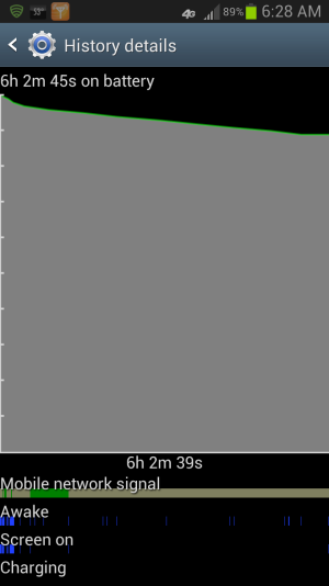

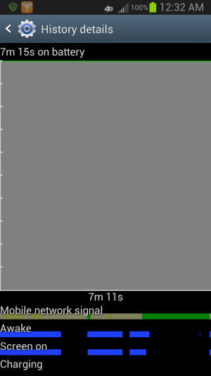

Turned off LTE and now at about 7 mins on battery, this is what I have - 100% and it is never at 100% that long. Also, I'm getting "green" in my signal bar.

Oh it usually drops at least 1% right away and I never had green in my signal bar, but I have 6 hours later lol.

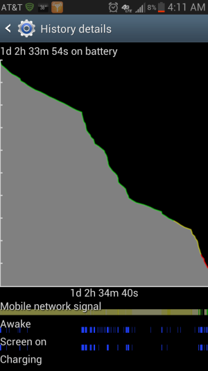

Got my new battery, in fact they sent me 2 :)
This is my new battery usage, have LTE on and about 5 hours of screen time.

Another thing I did, took my phone to an AT&T Device Support Center and had them just flash JB in my phone., They did a reset and flashed the new software and battery is back to normal and I'm not turning LTE off anymore.
