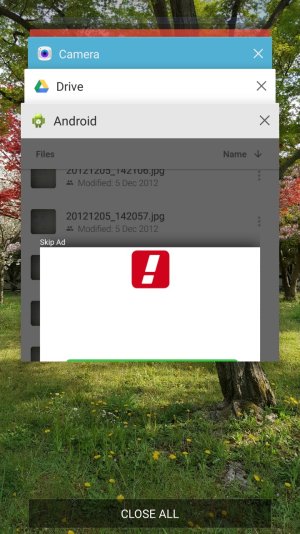

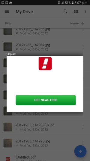

I did what you said and in my case it shows that the ads are coming from the android download manager. Screenshot_2016-09-08-01-02-28-448.jpg I tried factory reset and didn't work. I wondered if I can install a different download manager and delete this one but it can't be done. It says is factory app. Any help please. Would be deeply appreciated. Thanks, Vicky:(
Welcome to Android Central! It would help if you could post some screenshots, or describe these ads in more detail. Are they appearing in the Notification Bar at the top of the screen? Are they pop up windows? Do they occur when you're browsing the web using Chrome or another browser?
If they're in the Notifications, swipe down the shade and long-press the ad. Then tap App Info when it appears. That should tell you what app is responsible for the notification.

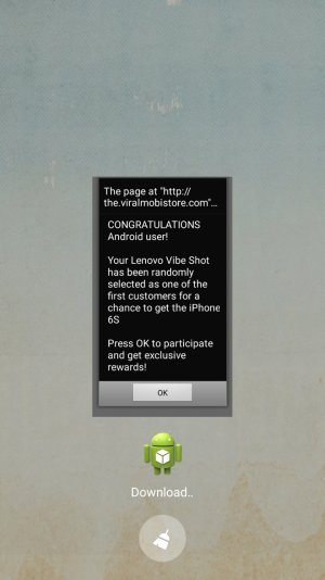

I found a solution, might not work for all cases, it did for mine though. My case was that, a window would open and subsequently it would be redirected to the Play Store featuring some game, whenever i unlock my phone. When i opened up Recent Apps, it wouldn't show a name as opposed to other normal apps. After searching numerous apps for a solution, i found this app called 'Perfect Uninstaller', it helps you search all the detectable add-ons and apps, from there i found a add-on/app being nameless, which is obviously the source of my annoying pop-ups. I deleted it and everything went back to normal.

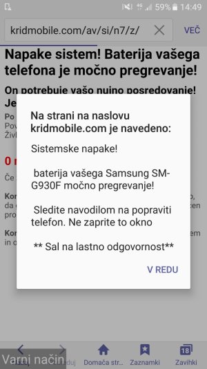

I have had the same problem found a rouge app called #### emulator and deleted it , no ads sins all i can't seem to get rid of is when i open my browser (any) it goes into adware sites...

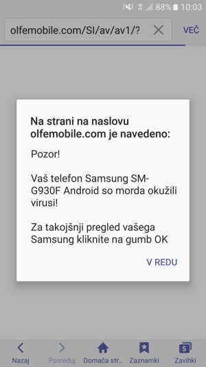

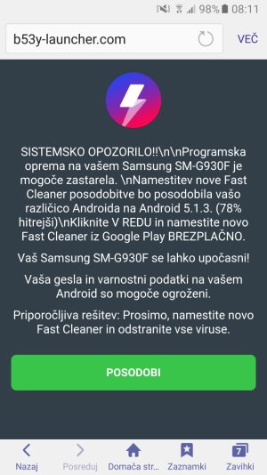

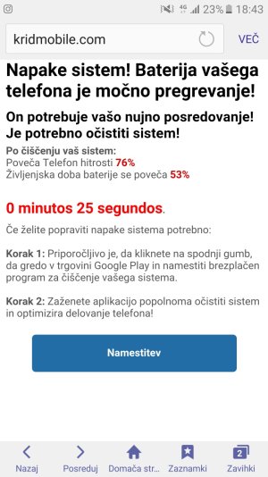

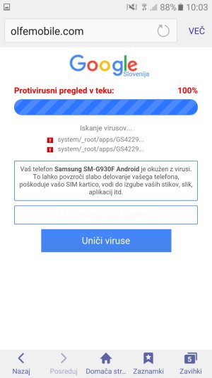

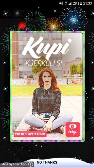

Problem:
Android 7.0 Nougat, Samsung galaxy S7
A lot of graphics commercials over whole screen: after the call, while on internet, after unlocking the screen
Information in the lower left corner "Ads by StartApp".
I could deinstall the programs because I have over 150 programs installed.
Solution:
I have installed Malwarebytes Anti-Malware (black/blue icon)
It found the following programs with malware:
AntiDroidTheft
Anycut
Lost Android
Learn to Draw Pets
Sex Statistics
Sextube
After deinstalling these 6 programs the adds stoped apearing (one of these programs was pop-uping the comercials).

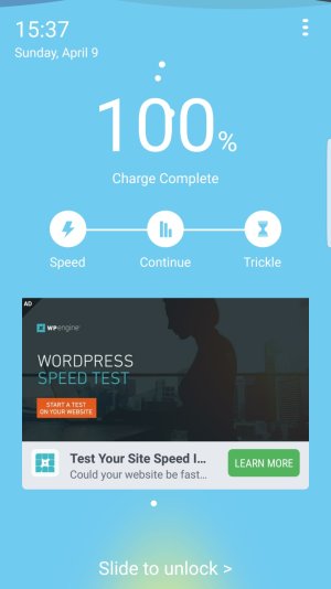

I just bought a new S7, no software and the ads are on the lock and home screens

I had the same type of ads as Arustyfan above. It was the ES File Explorer File Manager app. Open the app, click on the menu icon, scroll down to "Smart Charge" & turn it off. The Smart Charge feature says "Smart Charge - Display the current charging status, storage, and new files, including sponsored content" The key is "sponsored content" when you turn the Smart Charge feature off in the ES File Explorer app the annoying ads, or "sponsored content" that display on the unlock screen stop displaying. I think the Smart Charge feature is turned on by default, probably because it is a free app. In fact if you look in Google Paystore it says it contains ads. You can install the app & turn the annoying ads off though.
