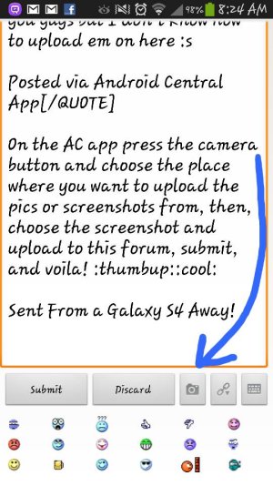

On the AC app press the camera button (if you're using the same AC app I'm using) and choose the place where you want to upload the pics or screenshots from, then, choose the screenshot and upload to this forum, submit, and voila! :thumbup::cool:

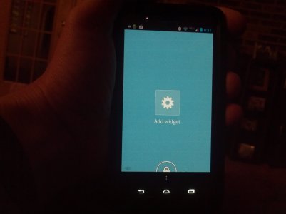

Here's a pic of the new lock screen:
One screen to the left, you see:

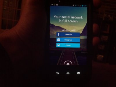

One screen to the right, you see:
Two screens to the right, you see:

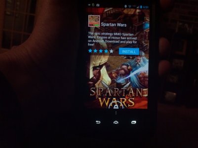

If you keep going right, you eventually get a blank page. But not before going through several ads like this.

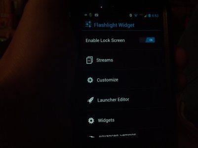

FIX
Go one page to the left, to the "add widget" screen. There's a hidden menu in the left border - swipe right from the left edge of the screen to pull it into view. Almost hidden at the bottom of this menu you'll see the top of a "settings" cog icon (sorry - I deleted the pic of this menu because it was blurry, then couldn't get that lock screen back for another pic because I turned it off and couldn't find an "on" option anywhere). Click on this and you should see this:
Just turn off "Enable Lock Screen."

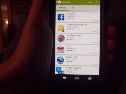

Looks like the lock screen was installed as part of a flashlight widget. I tried (and uninstalled) several before settling on Flashlight Widget by YourApps. So this is the culprit, unless one of the others left something behind when it was uninstalled.
