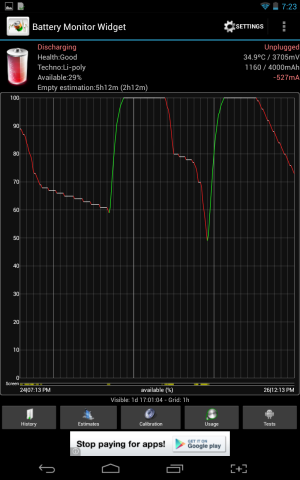

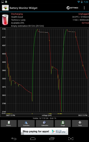

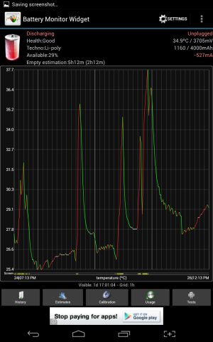

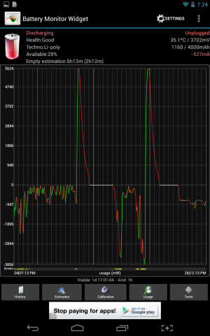

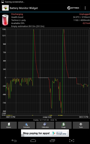

I'd like to get some input on my sero's battery, as it seems like it almost completely drains after just sitting, not being used for 8 hours and I'm wondering if I have a defective battery -- I also only have 4 more days to decide whether I want to return it.
I also had it plugged in overnight once and in the morning found it to be EXTREMELY hot and unwilling to turn on at all -- then I left for work and 8 hours late, when I plugged it back in I was able to turn it on but the batter was completely drained. Don't know what this means, and it hasn't happened again, but it makes me worry that my tablet might have a defect.
So I downloaded 'Battery Monitor' widget, which has in depth graphs to diagnose battery issues, however my problem is, I don't know what is normal and for the most part what anything means -- but I thought I'd attach screen captures of the graphs and was hoping maybe someone could tell me if they indicate I have a crappy batter or if this is normal for the Sero 7 Pro.
Any help or insight would be GREATLY APPRECIATED!!!
View attachment 83401View attachment 83402View attachment 83403View attachment 83404View attachment 83405
Don't know the app but It looks like it was charged only 2x in 41 hours going on to possibly need a 3rd. Not too shabby. I agree with the comments to check what is actually running and consuming power. I have practiced shutting down apps for 2+ years on my Toshiba Thrive in the pm and sometimes on the Sero.
The peak temperature on your charts is about 100F, slightly above body normal temperature. That doesn't seem to be too hot and from my unit in a PU leather case, I wouldn't even feel that. What is your power setting? I use power saving or balanced for most of my use and its fine.
You might check if the connection is good at the micro USB by repositioning the tablet while plugged in. I have
a problem with my original cable and even a Nook Simple Touch cable used as an alternate in that both have to 'drape' downwards with the screen face up to make continuous contact. I plan to call Hisense but suspect its the port and don't want to return the unit now after only 2+ months. My problem could be caused by my practice of keeping it plugged in most times at home and minor 'jostling'.
So basically -- my charts didn't look completely abnormal and bad is what I'm getting out of your reply. Even though it was only charged twice in 41 hours, I didn't really use it for a good ten hours during work, then another 6 hours while sleeping, so it wasn't heavy use -- but I was basically trying to see if the graphs showed some major defect.
I will have to check out what I have open and possibly switch to battery saver mode, especially when I won't be using it for awhile I guess. Does it make sense ever to power it down when it won't be used?

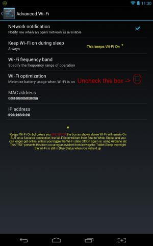

Question about the Sero 7 Pro, on my unit when it goes into sleep mode the WiFi drops out, when it wakes up I have to use Airplane mode I discovered is the fastest way, to get it to go back online. Weird part is the Icon for WiFi shows its connected to my network but the color changes to white like its an unsecured network, toggling airplane mode back & forth the WiFi signal turns blue and I can then access the internet again. Before I discovered to use airplane mode to toggle it, I would have to disconnect from the network even though it said it was connected (WiFi was white in color) and then reconnect again; toggling airplane mode is a faster work around but I don't have to do this with any of my other devices.
Anyone having similar issues?
After much trial and error, I found a solution to this issue see the attached screen shot I made to resolve this; it's really easy
So uncheck Wifi optimization for better battery and keep Wifi on? Sorry it was hard to read on the screen shot
Sent from my SCH-I535 using Tapatalk
Yes correct, also even though it says optimization for battery I found that it didn't have any noticeable effect on my batteries usage, as I tested this solution for nearly a month before I posted it.
I don't have the connectivity issue you have. For others who also don't, my experience with 2 tablets for 2+ years is keeping WiFi on during sleep is the 2nd biggest power user after the screen. If you're charging overnight, it doesn't matter much. But if you are traveling without a charger, you'll see it.
