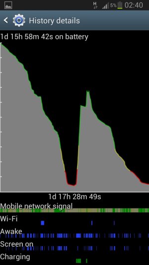

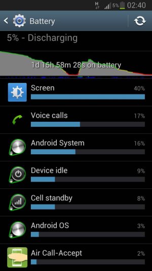

Anyway, here are screenshots from today when I've used it as I normally do, except I had brightness fixed at ~45% when normally I tend to forget it at 100% (yes I know what auto-brightness is). Please tell me if I can stop OCD:ing about my battery life being abnormal.
I took this when I arrived at work. I had checked gmail once, alarm had gone off once unlocking screen, watched 44 min of video.
Then I watched another 20 min of video, did 5 min of RSS reading in feedly. After that it was idle for 4h 30 min while working.
Then on the buss home I watched 10 min of video, and spent 7 min in feedly just reading RSS. On the buss it reached half discharge:
So if I follow this correctly (and I only have time to glance at it right now), you're at 50% after 10 hours, which would give you 15 hours with 25% left, assuming the same usage pattern. I really don't think you can expect much better than that, especially on 3G the whole time.

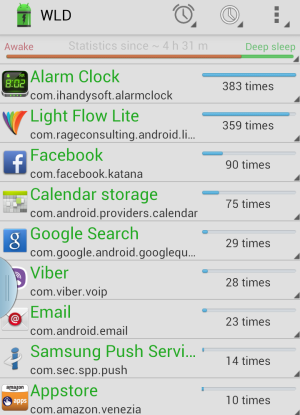

Advanced beginner (@ best) noob here! Been searching for a solution to my problem that was borne out of the same predicament that this thread was started upon so wanted to share what NOT to do. Do NOT (as I did) delete this file: com.android.providers.calendar. I went searching for the top things that were accessing my wake screen and deleted the top 4!
There's a reason that the Olympics give medals to the top 3 and I should have stuck with that model! Ugh! :'(
PS-If anyone has any (SAFE & easy for the computer semi-illiterate) ideas on how to fix that, I'm all ears (or is it all eyes?)
PPS-I'm on a Verizon GS3 (SCH-I535) running 4.1.2
PPPS-Though its not really apropos, I tried stuff from this post on androidcentral & did not help

These are my results a week ago. My battery is pretty good.
Sent from my GSIII

Your usage does alot to determine your battery life - if you'd like some help, fully charge the battery, let it run down to around 20% and then capture the three screenshots from the Battery view (main, History details and Screen on time) and post them here.
Sent from my rooted, debloated, deodexed Sinclair ZX-80 running CM -0.001 using Tapatalk
ok, thanks - will do :) ive stopped malaware bytes like i said, and changed my home page etc to a black one, so if it is still doing it i shall post screen shots :)
