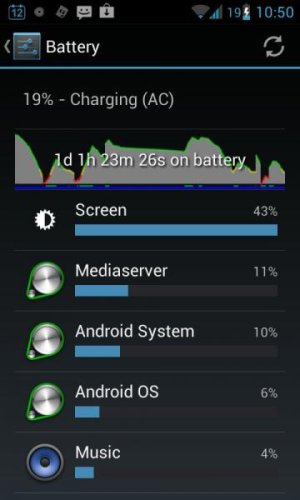

battery life is MUCH better for me over ICS. it does seem to take longer to charge but it holds the charge longer, imo.
Mellimel22
Banned
Mar 1, 2012
2,447
41
Visit site
As u can c I can totally agree wit u on battery life on jellybean :beer:
Sent from my Nexus S 4G using Tapatalk 2
