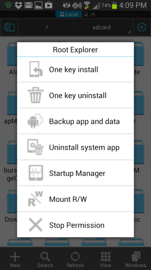

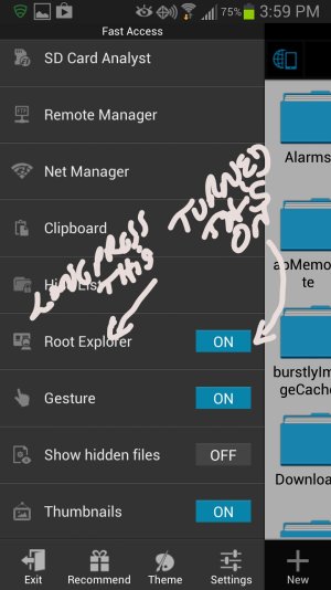

Synycalwon, thanks for the explanation. I'm able to get to the point of finding the files and copying them to the sd Card for backups, but I get lost after I turn on Root Explorer. I tried to change the .apk of both the files and rename them to .bak, but I can't rename them. I reboot and still can't change the file extensions. In your explanation of check Root explorer, I find it and turn it on, but after that I can't find the "up to root" and "mount File System" options. I have a newer version of ES File explorer and nothing like that comes up. I'll post a screenshot of what I have once I press on Root Explorer.

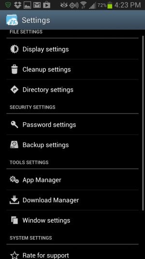

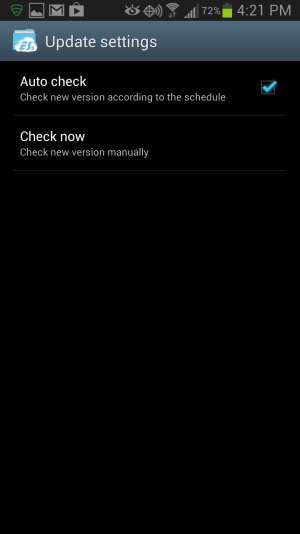

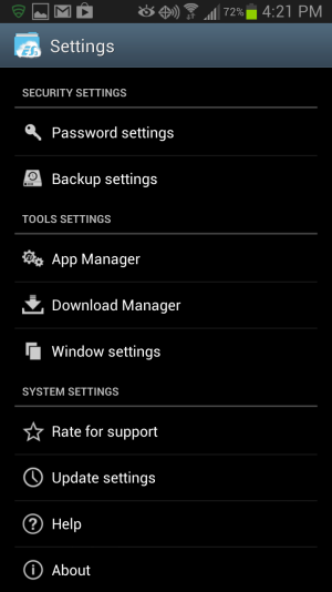

Edit: I did just try hitting the menu button like you said above, I get to settings, but nothing about Root Explorer. There is an Update Settings section and has the Auto Check function box ticked. I'm wondering if I just untick that if it would stop the update? I'll post a couple of screen shots again.

Oops, yup I'm using an older version of ES File Explorer yet (1.6.2.5). Sounds like they changed it. But if you can find/see the files already, if you long press on the file name do you get a "Rename" option? If so, what happens when you try to rename the file?
Edit: looking at your screen shot, try to enable "Mount R/W" (mount file system read/write). Without write ability, can't rename them.
Thanks, that did it. One last question. When I read the thread that you referred to above, they say to rename the Keychain.apk. Do I have to do that one also?
You don't have to, I didn't. Renaming just the two (FWupgrade.apk and SDM.apk) will stop the OTA updater from working. :)
