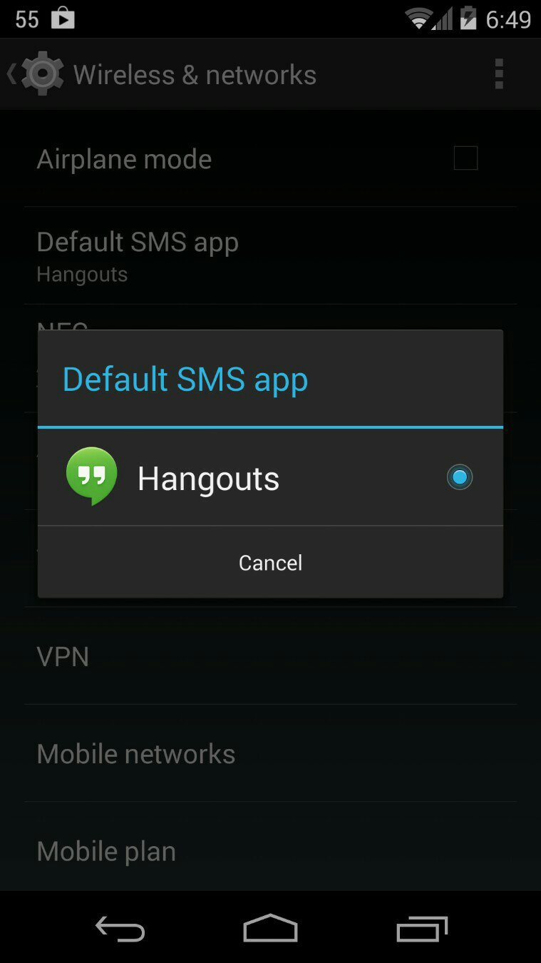

In settings, the only choice I see is Hangouts, although I've installed Textra, Chomp SMS, 8sms, etc. Anyone able to do this? Thanks.

Seems like the choice would be made here in settings. There's a radio button so other options can be selected, but no other apps appear.

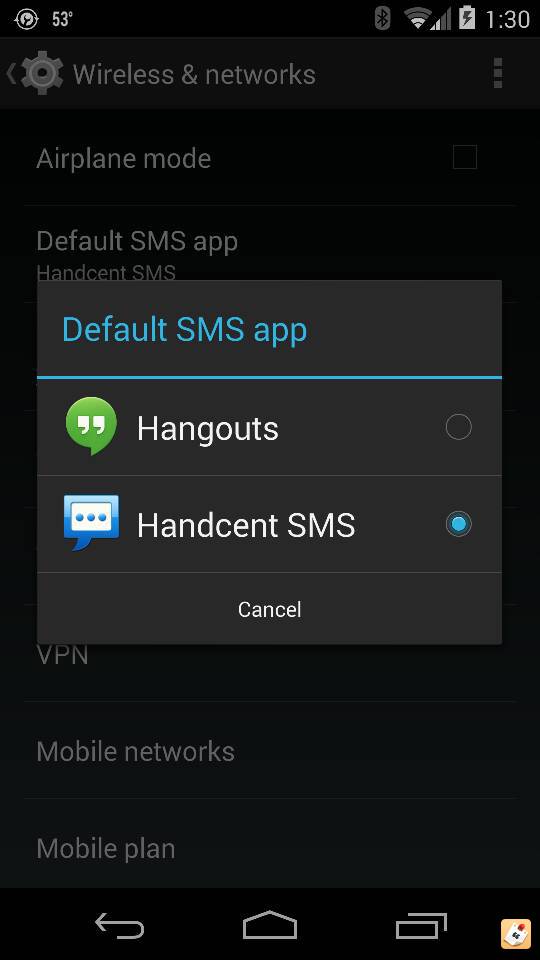

Handcent seems to be the only additional app I can get to show up in the list of default options. Perhaps for reasons already stated.

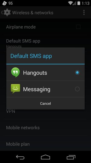

I installed the 4.4 ASOP MMS.apk, can select as default
Able to send & receive both SMS and MMS
