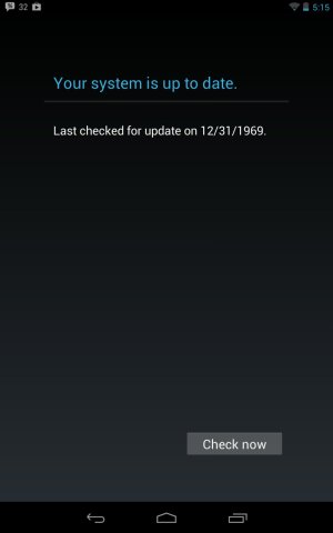

Thanks, it worked! Also, after I cleared the data, I got this funny message.
Yeah, that's standard with doing this process.
Really? Strange dates are the norm? New to android user here so I had no idea. Pretty funny.
I believe it's just the date it always shows after clearing the Framework Data. Not sure the reason why.
