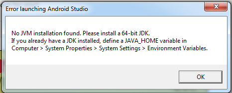

I have already tried this. The SDK wont run even when I install java. The tutorial there says to download 32bit Java so i did(i dont know the reason). But the SDK doesnt have two links for 32 and 64bit so i download the only one. But the android sdk wont run.

The message also said clearly:
As I said earlier: This seems to be a little bit over your head and I would suggest that you find someone in your area to help you with it. Either that or try to contact your tablet manufacturer's support team. Maybe they have a trick in their sleeve that we don't know about.
