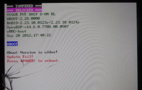

I have tried to go back to stock after rooting & installing CyanogenMod 10.1.3.1 (Vigor) & it failed, it said something like HBOOT is older. I'm using TWRP for recovery.
I had the device relocked when I did it. I have a photo of what it said, I'll see if I can put it with this message. I also tried istalling the .exe one with my computer. I got the URR from Android Police.HBOOT 11-28-2013.jpg

There is no RUU for the current firmware (the one you are on)... the only way to get back to PURE stock is to S-OFF and RUU back to 3.14.605.12 then step-up from there.
However, if you are looking to return to stock try [ROM] OTA-Global-Stock-4.05.605.14 710RD-Rooted 5/1/13 - xda-developers, it is completely stock with only root added, it will fool almost anyone and return the device to as stock as you can get without going S-OFF.
