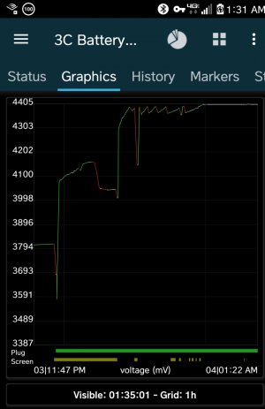

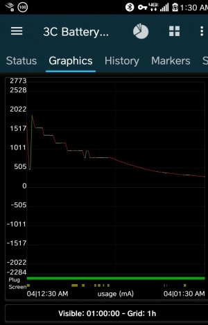

I don't have a separate tool for checking this, but these are from one of my monitoring apps. You can clearly see, that at least with LG, the saturation phase has the draw down of charging current as expected. (Fyi, the voltage graph scale is over a longer time period, so I could show the voltage increase before saturation.) I suspect I'd see similar results on an external meter, which may still be inaccurate unless charging with the phone off.
Also of note, the Lipo's LG uses are rated at 3.85 nominal voltage, not the usual 3.7V. I remember reading in one of the Battery University articles that newer technologies/materials have allowed for these slightly higher charge voltages without severely impacting safety or longevity.

Charge voltages beyond 4.2V have a very material impact on battery life, and LG, like every other cellphone company, runs their charger at well beyond 4.2V.
This is how they (and everyone else) shortens the "absorption" phase -- they drive it harder. The "chemistry changes" people talk about in terms of allegedly higher nominal voltages doesn't translate into "you can run that higher charge voltage during absorption without impacting cell life", however. What it does do is reduce, to some degree, the heating that results during the absorption phase -- but the damage is still taking place.
