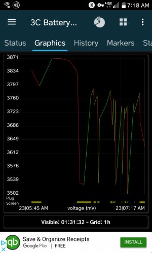

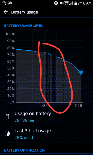

How can you tell if your battery is going bad? This is how.
My phone was up and running the entire time, so I was confused at first. Then it hit me: voltage sag.
(The numbers on the left are voltage, listed in mV)
When a load is put on a battery, it's natural for the voltage to drop a little. How much it drops can help determine the health of the battery. A healthy battery will not sag very much. A worn out battery will sag quite a bit. If it's bad enough, this sag can go below the minimum voltage required to run your phone and that's why you'll start to see it shut off when the gauge reads well above 0%.
When I compared these voltage drops to the amperage history, it was consistent. Every time the current spiked due to me doing something on the phone, my voltage tanked. I suspect the drops were so rapid that it confused the phone's battery gauge, thus erroring out with a blank reading like you see in the first screenshot.
