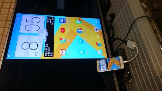

I'll keep you posted!
Looking at Google USB-C HDMI cable, no but unsure about slimport USB-C HDMI cable? Was also hoping phone screen would switch off when cable plugged in.

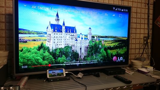

Does it support full 4k UHD (3840x2160) over DisplayPort? I'm interested it using it to display 4K video directly out to a UHD TV. YouTube compresses 4K (2160p) to death until it looks little better than 1080p, so I'd like a method to display content recorded from my phone.
So we have confirmed something is available for us to plug into the 10 to stream on our TV's via cord? Is that what I am seeing here?
Bump for this^. I have no idea regarding this type of device so someone please tell me in the most basic of terms; can I plug this between my phone and TV and see phone stuff on the TV? :p
It sure seems that way :)

Indeed! It seems that many hotels no longer have DVD players and opt for cable instead (yuck) so I'm hoping to be able to load up some movies on the phone and be able to play them in the hotel rooms. I've no clue if that's what I'm looking at here but I'm interested. :)
Seems simpler than a Chromecast too assuming the hotel hasn't locked down the HDMI inputs on the TVs. :(
