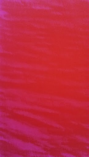

Everyone that is having the purple problem, try this:
  1. Take your phone and place it on a flat surface, camera side down.
  2. Turn ISO up to 1600 (if not on Auto) and watch what happens. The screen shifts red.
  3. Go in and set ISO to 100. Does the red shift disappear after a few seconds and shift to blue? It does on mine.
Simple experiment but it's pretty telling to me. It can be corrected with software, it's something they changed in 4.3. Now the people who have had their cameras replaced may haev received units that can handle the higher sensitivity so they require no change in software.
In my opinion, barring defects, there isn't anything wrong with the original sensor per se. Whatever changed they made to the camera software/firmware in 4.3 seems to have mucked it up.
[Edit]Heck, you can step through the ISO settings and watch the color change shade. Tweaking the White Balance and/or ISO behavior should clear this up.[/Edit]

The camera problem for most seems to be there even before the 4.3 update.
I've had it since I got the phone on 4.1
I tried your steps and did not get the same result. Mine goes purple and stays the same going through the ISO settings. Letting it cool down to 25C and trying it, the image is blue and goes purple as the temp increases.
This is a hardware issue. Simply changing the software settings won't fix this.

It's a hardware fault,the proof is that if you place your One in a freezer for 5 minutes and try the camera,the purple tint goes away for about 30 sec,it comes back gradually because the phone is heating again.
It's not Zoe either (she's a good girl)
It can be a simple fault in production design or component,voltage gone bad,battery juice leakage,heat isolation (thermal paste)...
