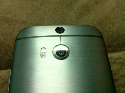

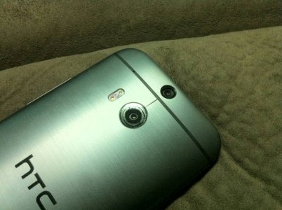

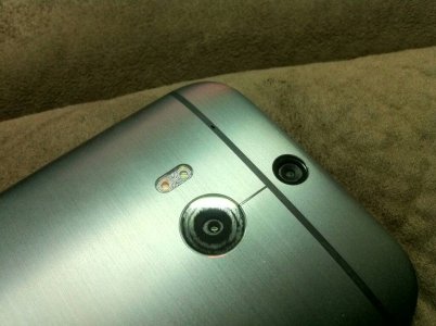

Re: HTC One (M8): Camera lens cover issue
Here are some pictures of my M8 camera lens glass after cleaning only the centre with a circular motion.
uploadfromtaptalk1410050331495.jpguploadfromtaptalk1410050343753.jpguploadfromtaptalk1410050356487.jpg
Sent from my HTC One M8
