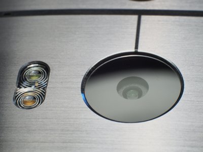

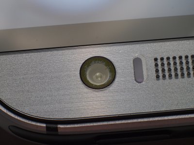

Just saw this issue on my Daughter's M8. As a materials scientist of some decades, I have some experience in similar failures, and I hope these comments will help. I looked under my microscope, and it's clear the "scratches" are actually like tiny tracks of bubble-like defects. These are 100% certainly in the coating on the lens cover and ARE a manufacturing defect. I'm not sure how these coatings (maybe magnesium fluoride or similar?) are applied, but CVD/PVD (chemical or physical vapour deposition, in a vacuum chamber) are typical treatments. If the glass/plastic isn't microscopically-clean, or if the coating or application voltages aren't correct, the coating will be the wrong density/composition, so will either be weak, or poorly-adhered. It could even be that moisture in the air or skin acids will cause it to fail. The degree of failure will vary, and that explains why removal may take just a wipe, or something much more aggressive. The very bad news, is that being a vacuum process, the coating is applied to both surfaces, and by focussing through the glass, I can see defects on both sides of the glass, and of course, you can't get to the inner surface. Don't let anyone tell you this is abuse, or lack of care...it is definitely a manufacturing process defect. Maybe someone should start a class action with HTC? If all else fails, I may take some metal polish or similar to my daughter's phone, but this won't cure the inside, and as others have said, this is a well-specced expensive bit of kit that certainly shouldn't fail in this way. Our first stop will be back to the supplier.
On the phone I looked at microscopically, the lens wasn't affected at all, only the lens cover. As I said above, the lens cover is affected both sides, inside and out. As an update to my post above, we talked to the phone provider, who put us in touch with HTC. They seemed very familiar with the problem, and I have no doubt they know exactly what caused it. Probably fixed now, but with many many phones affected.

The "creep" came over my camera a month ago and I was just about done with HTC. I do so much photography with this phone and now everything was hazy. I had tried 93% alcohol, LCD cleaner, 2 brands of toothpaste, 2 types of automotive polish. No improvement at all. As a last-ditch effort I rubbed a little PlastX with a Q-tip. Didn't expect anything but, miraculously, it cleared away the etching!! Not a single scratch on the lens.

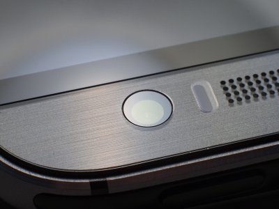

Mine got bad quite quickly after around 4 months of careful use, giving results that looked like they were taken through a Vaseline filter! I emailed HTC UK via the website, and though quick and helpful, they said the replacement was unlikely to be better than the original. Rather than do it again in another 4 months, and encouraged by good samples here taken after removal of the coating, I bit the bullet. I had some silver polish, so put a small amount on the end of a cotton bud, and worked around in circles on the main lens cover. The central part came off easily, but there was some left round the edges. I refreshed the polish as it dried out, and followed the recess round carefully. It's not essential to clean right to the edge, but I didn't want it looking half-finished. I also did the duo lens cover and front cover too. The latter had almost all come off centrally already, and was a stronger green colour. It now all looks as good as new, apart from a small scratch on the edge of the main rear camera, but that won't affect images. The cameras perform as well as I remember as new, even into bright light, so no regrets.
Here are a couple of before shots of the main and front covers:
The same after:
And before and after shots with a glary, cloudy sky:
2014-10-15 15.42.32 rear cam_800.jpg2014-10-16 14.34.25 rear cam (coating cleaned off)_800.jpg
If you do this, I would contact HTC first, so they know the scale of the problem. If you just bodge it, they won't know.

No, I didn't see any reason to and honestly didn't even expect it to work. It basically went exactly like the pics above. Total spider web, then crystal clear. Important thing to note, the factory coating is a grease magnet and I was constantly wiping the lens. Without the coating it stays cleaner and when I wipe, the grease comes off instantly, which it never did before.

I used a drop of toothpaste on the lens and rubbed it slanting with a toothpick for sometime. Make sure u do the edges too .then had a drop of aftershave on it and den rubbed a bit more wid the toothpick. Finally wiped it all of to get a brand new looking lens .

I noticed very cloudy photos on my HTC m8 as well. I had some lacquer thinner in the house and use that with a q-tip and buffed the lenses with a microfiber cloth and now they are crystal clear.

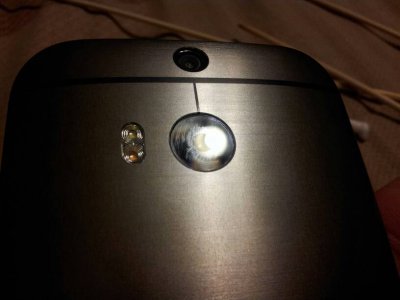

Welp, look what I just woke up to.
Just one week with my M8, which has been in a Bodyglove Satin case, babying the phone to the point where I don't let others even try to hold the phone and this happens (might be user error on my part as nearly an hour of Asphalt 8 and Five Nights At Freddys 2 heats up this bad boy quick)
Getting the layer off only took 10 minutes of light scrubbing with a q-tip and toothpaste, though I did press down too hard on one area and the lens itself has sunken in a bit deeper. (Will upload image of lens once I get back from work) Went to my local T-Mobile earlier this morning and showed the rep and he said even though user error was present, it can be still be replaced as the defect was widespread and most, if not all M8's are still affected.

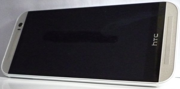

Hey Guys,

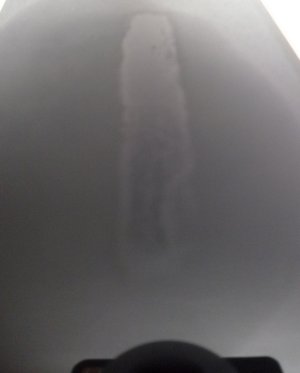

I have on my HTC One M8 display strip from top to bottom.
Under normal conditions, you dont even see it, because it's not noticeable (visible), but eg. In larger differences of temperature or humidity rapid transformation or simply if you breath on display, when the glass fogs up, it is obvious and appears there is a clear streak.
Glass of display ofcourse I tried to clean with alcohol, toothpaste,...., but it does not disappear.
Have you ever seen it?
I had all of my Camera lens dirty too, so that I cleaned with toothpaste and water and credit card... good instructions in this forum.
Sorry for my english... :-)
