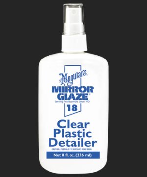

I finally developed the dreaded "blurry, cloudy" picture problem. I used Meguiar's Plastic Cleaner spray. Made for this job. Took away the haze. No scratches. Looks like new. Photos are sharp again.
