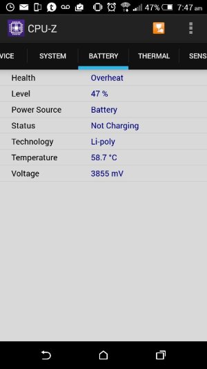

My biggest worry was the battery.
We agreed that he was lucky his battery never reached 60 degrees or it would've exploded.
