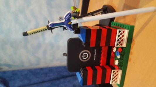

And would you look at that:-)
Oh, a Lego charger stand.. Speaking of Legos... Dragon completely made of Legos @ WDW.

Glue a Lego to the tip of the base of the charger and it will keep your phone from falling off. Problem solved.
