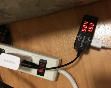

If everything works before they should work now. Make sure you connect the USB charging flex cable correctly, the line on the cable should align with the line on mainboard. Try to reinsert it without battery connected to mainboard, then plug in your USB cable and adapter to charge; if you connect correctly, the green battery indicator should be on briefly then show 100% full charge. Your new digitizer has nothing to do with charging problem.
One more thing, your LCD cable should do the same, if it's not properly connected, you won't see anything on the screen, a black screen may make you think the tablet is not charging.
This tool will let you know if the tablet is charging:
usb current and voltage tester | eBay
