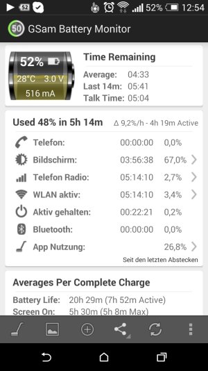

Hey, I have got a problem with my m8. The battery power is not as good as i thougt. I'm always reading that the usual Screen on Time is 6-7 hours.
I'm only getting about 5 hours. And when I am Browsing on the stock browser I'm losing about 1% all 3-4 Minutes on medium brightness.
GPS, NFC are all deactivated. My usual usage is whatsapp, facebook, browsing, youtube, a bit games.
Here are some screenshots from Gsam battery monitor:
805f2ba3401391c41b969e0e170a07c5815be7e8b4301baaffcd167af08b282c.jpg af7b51f254c05bf1811cf2814bc2f208c58ffde8d02aa9fed4a6af5fd994dcf3.jpg
So is it looks normal or should i send my m8 to repair?

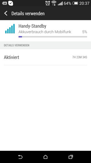

Welcome to Android Central! How is the cell signal throughout the day? If it's poor in some places, that can contribute to battery drain. Show us a screenshot of your Settings>Battery screen, and if you see Cell Standby, tap it and show us that screen as well. I'm interested to see the "Time Without Signal" figure.

Hi, when i am at home i'm using wifi. At work i have either Hspa or EDGE. I am not sure about how strong the Signal is but i think its medium.
I saw here screens from the m8 with Gsam with 7-10 hours Display on. Thats why i am thnking my battery sucks.
Do you mean this:

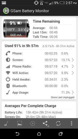

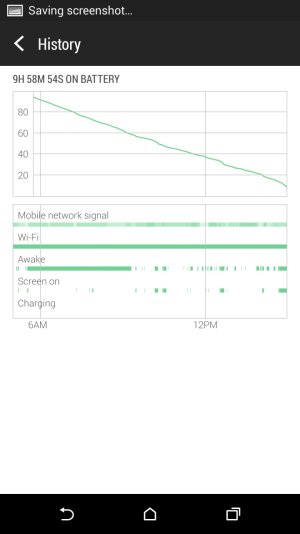

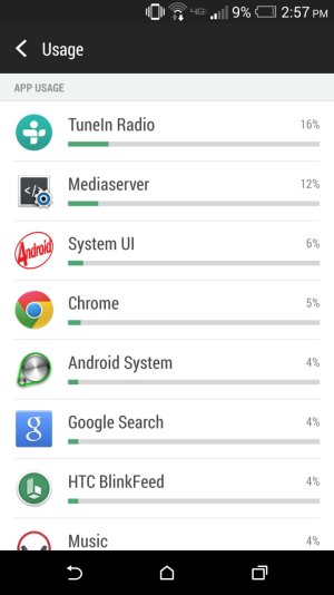

Does only 2 hours or so of screen on time seem awful? Here is mine from today after listening to tune in radio for 3 hours, music for 5 and not much screen on time. My battery seems to go down a a couple percentage points every time I turn the screen on for a few minutes. It went down5% while I was working on this post and attaching pictures...
That really weak wifi signal isn't helping.

Were you listening to music on headphones or over the speakers? If the latter, and if you were listening at a loud volume, I'm guessing that could have eaten up a good amount of battery. Those high quality speakers come at a price!

It was with headphones, so you wouldn't think that would take much battery. Every time I turn on the screen, the battery drops a percentage or 2. I might try going in to Verizon.

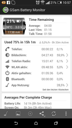

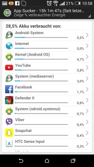

So here is a screen from Today. It seems to be normal. I'm watched the most time videos on my Browser.
And what means System (mediaserver)? That sucks the most battery in app usage.

I believe media server is when you listen to music or watching videos might count as well, probably anything media.
And I definitely think my battery has something wrong now. I don't think I've ever had more than 3.5 hours screen on time, and you had that on half your battery.
