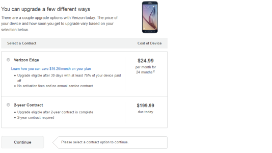

When you ordered, what options did BestBuy give you for choosing your plan? I thought there was supposed to be some option that says "Keep existing plan" but my only options were Verizon Edge and 2-year contract. Am I supposed to choose 2-year contract? Nothing on the checkout page says anything about keeping my existing plan. Should I be concerned? I see the following pages:

Re: [Instruction] How to Keep Unlimited Data on Verizon
You want 2-year contract and there is nothing to be concerned about. This is pretty standard stuff. There should be an option after selecting 2-year contract to "keep current existing plan", but if not, do not worry about it. The methods still work because the plan change does not happen until after you activate the phone.

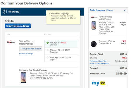

In my order receipt, it says this:
Verizon Wireless Plan
These new charges will be added to your carrier bill and do not include all taxes, fees and surcharges. Discount or data plan changes previously messaged will be applied to your plan.
One-Time Charges
Activation Fee - Line 2, $35.00
They also added the Samsung wireless charger for free...
Update: I checked the 'order status' on BB.com and it says this: Verizon Wireless - Keep Existing Plan

I am almost in exactly the same boat, except for me it says "Verizon Wireless Mobile Package" and when I check the order status on BB.com it doesn't say anything about Keep Existing Plan.
As duosoccer hinted at, I think the correct step is to actually program your new nanoSIM simply by entering in both the nanoSIM number (not sure of the official name for this) and your S6's IMEI# at VZW's website. I believe then you pop in the nanoSIM into the S6 and you should be good to go.
