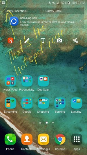

re:
Here is the icon of hotspot on att note 5.uploadfromtaptalk1441332856156.jpg
Sent from my SAMSUNG-SM-N920A using Tapatalk
re:
Yeah Double. I get that icon on my S6 when I remove my sim from the Note 5 and put it in my S6 but the note is not working for some reason....same settings under mobile hotspot options as S6 too...don't know what's going on here but I'll post back after I get a chance to try Diddy's recommendation and maybe the dreaded "hard reset"...
