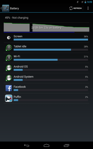

Hi Guys,
Need your advice & comments...
the battery on my N7 II has been "discharging" much faster than average recently ...
ie about 5-7% per hour ... is that normal ?
and that is rate that when I am not using .. ie "sleep /standby mode" ..
I have switch off Blue Tooth & Location Service ...

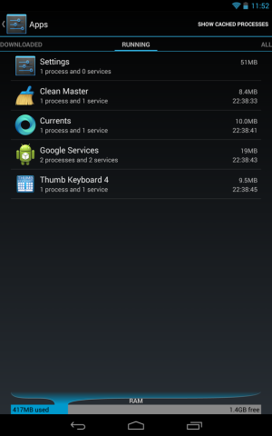

Left with Wifi On only... and from the print screen ... i dun think there is any bloatware / malware running in the background
I have run the battery flat and recharge back to 100% overnight .. it seems to be "normal" for the first day - using for 2 hours ...ie battery level ard 80% plus ..
then the next day...the battery starts to "discharge" rather "quickly" ...
without using ... in standby mode ..

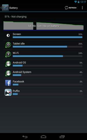

Just a thought for troubleshooting, try putting it in airplane mode for a bit and see what the results are.
Hi Gabbott,
thanks for your comments ....i will do that,...currently standing at 50% ...will report the status in a few hours time ...
Hi gabbott
my battery level drop only 2% !!!! (from 51-49%)
(instead of the 5-8% PER HOUR!)
so does that mean that is something "wrong" with my home network/Wifi?
what can I do about it?
ps: least i know the battery on N7 II is working "fine" now ... instead of "leaking"...
I am using WP Nokia 1020 as my cell phone, the battery discharge is very normal, about 1-2% per hour(when connected to home wifi/network) ...
