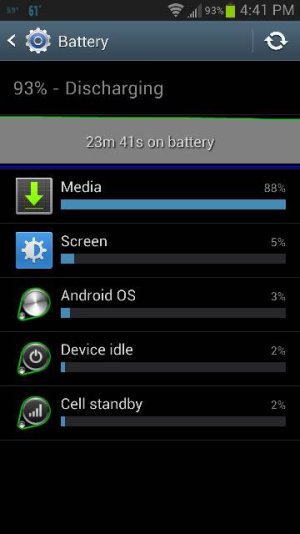

This is after 20 min on standby. It lookd like it never goed to sleep mode.

No result after battery removal. Media (whatever that is ) kills battery from 100 to 53 in 2.5 hrs with phone not being touched. Phone is unusable .

This is a well known issue with the update. Take your media files, and your pics, that kind of stuff. In one of those .andoid type folders, is a file that corrupted with jelly bean. Reformatting the SD card helps.

I restarted a few times with battery out, recalibrated battery,
Nothing worked. Then I just took the SD card out. Batt life improved. I do not how much it improved yet. Media is not the biggest consumer anymore.
Battery life improved a lot after reformatting the sd card. I think it is better than ICS.
