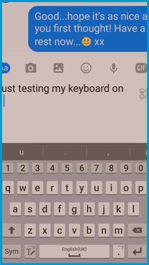

It's had a screen protector on since I bought the phone - so two years - but I've now taken that off anyway, just to see if it made any difference but it's still happening. Even trying to alter a time on one of my calendar memos it happens - seems to 'jump' and go to a different type of screen, and that's when the blue 'frame' appears. When I type anything, I can sometimes get as far as a few sentences before this happens, but other times just a couple of words. I have to go back on my phone a couple of times to get to rid of the screen with the blue frame, and then I can delete all the random letters that have appeared and finish my messages, emails etc. I'm on the desktop now as I have given up! The attached screenshot shows the blue frame - I had started a message to my daughter - if I had carried on random letters would have come up. I've noticed it seems to be letters from the line below I'm actually typing that pop up. This happens on both the Samsung keyboard and SwiftKey one btw. Could it be something to do with the screen rather than the keyboard, or the inner workings of the phone itself? No idea about these techy things as you can tell! Any help appreciated as I need my phone for my job. I may have to take it in somewhere later to be checked out!

Well the boarder around the whole screen is unusual. It almost looks like it's intentional... Anyway with the random letter being the one below your intended target has me thinking calibration. In some keyboards there are tools to calibrate the touch input. You would have to look at the settings by going into language and keyboards selecting your input method and then seeing what settings you have for that keyboard. Your device may also have some calibration settings but on my HTC I can only calibrate the g sensor and not the screen.
As for something internal, if your device took a sharp rap on one of the sides or a corner it could have loosened the cable connecting your digitizer but if your digitizer was the issue typing wouldn't be the only thing you'd notice issues with. In situations like that the whole top or bottom would be unresponsive or other things would be going haywire. If your processor was damaged like say because of overheating or something when you used the phone it might start out ok and then as it began to work and heat up things would probably get worse and worse which could also explain the blue boarder. This doesn't have any of the other tell tell signs of that so probably not. It's not contained to one app so not likely an app issue. I can't see it being a resource issue, like low RAM due to thousands of SMS or an overloaded CPU.
Taking it in to your provider may not be a bad idea in this case. You could try another keyboard just to see if it's the keyboard app that's the problem.
