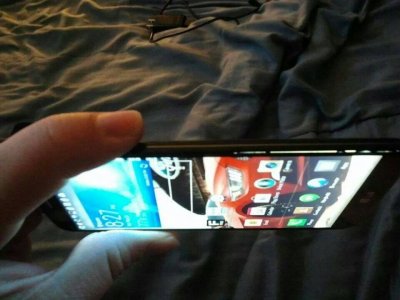

Well this is the touch screen issue that I am having, the entire screen is coming apart. I am getting a replacement G2 in a week though

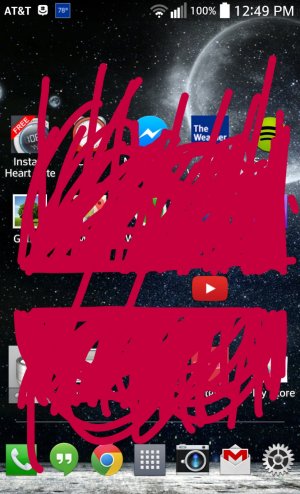

If I try the QuickMemo test, if I start at the top half of the screen and draw lines, it stops in the middle and won't pick anything up on the lower half of the screen. If I start anywhere in the bottom half, and draw lines, it stops in the middle and won't pick anything up on the top half of the screen.
I also tried the test by turning on Universal touch under General -> Accessibility, grabbing the icon that shows up and when I sweep it over the screen, I notice it jumps around the center and left of center, like that part of the screen is messed up.

This is what quicknote did (when I could still access it...dont know how other than pulling the bar down)
That's the exact same location of my dead zone. I hate it because you cant make purchases in the google play store unless you turn the phone upside down. -.-
