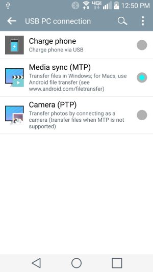

Google's had this one listed under the known issues for a little while (https://support.google.com/androidauto/#6200174), but I had to try for myself anyway, now that the Verizon G3 has Lollipop.
And sure enough, it's a nonstarter. I'd forgotten that LG has those different USB options, and that's obviously jacking up Android Auto. :-/

What does the LG G3 do if you disable the Verizon installer stuff?
In the dialer type ##3328873, hit send, service code is 000000, and in the menu uncheck "tool launcher enable".
(forum.xda-developers.com/showpost.php?p=55725408&postcount=1)
Since no one seems to have tried this, I just tried it myself on a Pioneer AVH-4100NEX display at Best Buy. Completely stock Verizon LG G3 running 5.0.1 but with the Verizon installer crap turned off as described above, and it worked flawlessly.
