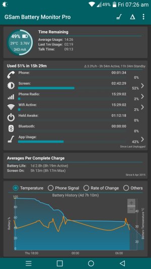

Another battery life screenshot.. Mixed usage including some games.
Idle over 6 hours, dropping 1%.
Half health shot:
Oh, this includes about 40 minutes of playing Spotify at nearly full volume from my pocket. That will explain the Held Awake time being so high.
