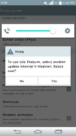

I thought mine was the only one. Mine is checked and I don't see anything. Interesting. Its raining now and still nothing.
It depends how often you have it updating, if it was raining now and it won't update for another 2 hours it won't show unless its still raining when it does
go to settings then lockscreen and then check widgets box. (show widgets on lockscreen)
then go to lockscreen and pull down the screen.and then push the screen right and add widget and choose weather. after do all you will see its working. thats all.

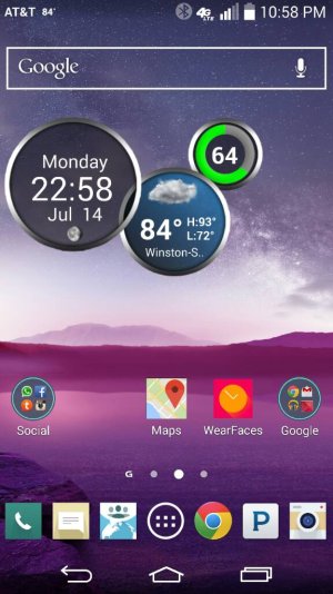

So I removed the widget. But I cannot for the life of me find it again. There are only 2 weather widgets and neither one is THAT one. I wanted it back because it follows you and gives the current weather for wherever you are at the moment. The other two widgets make you select a location and cannot follow you. Pain.
I've tried to install the Rings app to no avail. It doesn't change the color, it doesn't save my location. Any suggestions? Very frustrated. :'(

HOW TO FIX:
First, it doesn't matter if your LOCATION SETTING is on or not- mine is not on.
Second, i have my SYNC turned ON. (Not sure if this is a factor or not.)
Third, make sure the WEATHER ANIMATION is checked on in the LOCK SCREEN SETTINGS.
Now, within your stock "weather"app, go to the CITY LIST. It should be up at the top right next to the plus icon and settings icon.
Delete all your set locations.
Then, add a new location and type in your area code. (THIS SHOULD FIX IT)
If it doesn't work, add a new location again, but this time instead of entering your area code, click current location.
I have both, the city with the zip and current location, even though they are the same city.
I've seen snow and rain so far, it looks good. Hope this works for yall!:)

Also, the weather has to be raining or snowing in order to see the stock weather animations on your G3. And i didn't mean to post it twice, sorry!
