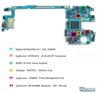

Got the same problem here. Refering to another forum discussing this issue, this problem has nothing to do with software. It's a totally hardware problem: the chips for BT/wifi! My solution is, after reading....
[Q&A] WiFi stuck on turning on; MAC 02:00:00:00:00:00; G2 G3 G4 G5 Nexus5 Nexus 7 etc
putting some paper card directly on the chips responsible for wifi and bt functions, in order to apply some pressure on the chips. Your can locate the chips by reading the service manual of LG D855.:D
I found solution for this.Open the phone and locate the chip for wifi,bluetoth.You mast have heat gun.Set the temperature in 250 and heating the chip for 2 minute and pres the chip bot not verry strong to motherboard.Leave for 5 minute and testing.Everything working again for me.Also you can ad termopaste in procesor for good cooling
