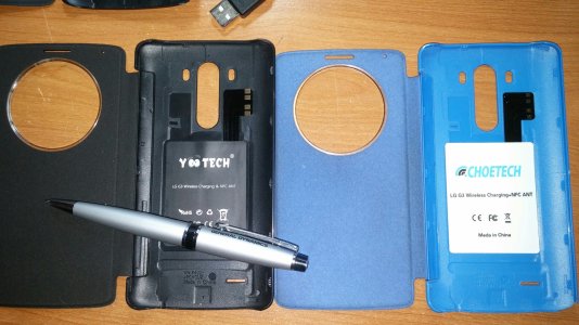

I have a Verizon LG G3 and am finding myself quite puzzled. I have purchased several circle cases with wireless Qi charging and initially had 100% success with them. However I noticed that even a minor drop usually chipped the case so I purchased a few more. This time when the cases came I noticed that putting the new cases on my phone made wireless charging no longer functional. I could put my old (chipped) case back on and everything worked fine.
I have multiple wireless charging stations and all are behaving the same way (I know about the amperage issue and made sure my transformers all have plenty of power). I'm attaching a photo of the two cases that I am currently playing with. The black one on the left doesn't work and I have another black Choetech case that also does not work (even though it has the 4 connectors) meanwhile the blue case works every time on all of my chargers... I'm beginning to suspect a pin alignment issue (and need to get myself a dry erase marker) but I'm wondering whether anyone else has seen this. Interestingly the Yootech case seems to have larger contacts but still doesn't want to work with my phone...

I was having an issue with one receiver not aligning so I loosely taped it to the phone first then put the back on, worked like a charm.
Thank you View attachment 160091
