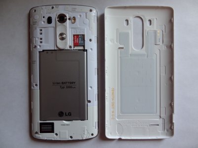

My Sister has a Verizon variant, is that compatible with Qi if I swap the cover out for LG G3 White Replacement NFC Qi Wireless Charging Rear Housing Battery Cover | eBay, or would http://www.amazon.com/Wireless-Char...ag=hawk-future-20&ascsubtag=UUacUvbUpU4056179 be a better option, take the NFC sticker out and replace it with that one? Also, what's a good Qi charger for the G3 that's under $35, e.g. easy to use, charges at a decent rate, doesn't have problems, and would preferably work with http://www.amazon.com/Incipio-DualP...ag=hawk-future-20&ascsubtag=UUacUvbUpU4056179.
My Sister has a Verizon variant, is that compatible with Qi if I swap the cover out for LG G3 White Replacement NFC Qi Wireless Charging Rear Housing Battery Cover | eBay, or would Amazon.com: LG G3 QI Wireless Charging + NFC Antenna Sticker for Verizon VS985, T-mobile D851, Sprint LS990: Everything Else be a better option, take the NFC sticker out and replace it with that one? Also, what's a good Qi charger for the G3 that's under $35, e.g. easy to use, charges at a decent rate, doesn't have problems, and would preferably work with http://www.amazon.com/Incipio-DualP...ag=hawk-future-20&ascsubtag=UUacUvbUpU4056538.
I have the same phone and I put the qi/nfc sticker from amazon in it, and it works great. I use the Tylt Vu charger, it's a little on the high side price wise, but I have used it on 3 phones and had no overheating or not charging issues. They may put the charger on sale for the holidays, they did last year.
I have a sticker I got off ebay. Works fine, and a lot cheaper than a new back. Scraping the old sticker out of the back was the hardest part of the install.
As for chargers, I have two of these Powerbot pucks, and they work great. I tried some other cheap chargers that didn't work at all, but these have been fine: There are rubberized rings on the top and bottom that keep the phone and puck from sliding around.
http://www.amazon.com/gp/product/B0...ag=hawk-future-20&ascsubtag=UUacUvbUpU4056930
I borrowed one of these at work, before I bought my second Powerbot, and it seems to work fine, too. More expensive, but it includes the AC charger. But because the back of the G3 is curved, and this if flat and smooth, the phone tends to rotate if you try to operate it while it's sitting on the charger.

Any idea why this Qi ebay sticker is saying that it WILL NOT work n a US model G3?
Which ebay sticker? Without a link to the exact product, all anyone can do is guess. But the Korean version of the phone has the charging contacts positioned differently than the U.S. version, so that could be the reason. Post a link and I'll be happy to take a look and see if that actually is the reason.

The European version should come with a Qi coil built in, and should work fine with your Nexus charger.
My understanding is that Qi charging support has been disabled in the AT&T LG3, so even with the right antenna Qi Charging will not work.
-spg
The AT&T version is incompatible with Qi, but compatible with the PMA wireless charging standard, which include Powermat devices. But the charging coils are different, so you'd need to get a PMA compatible back or sticker, not the Qi version.
