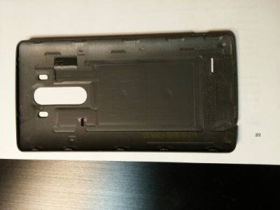

This is the back cover that came with my sprint LG G3. Is this cover Qi compatible?
Idts as I don't see any of the necessary pins.
Sent from my LG-D850 using AC Forums mobile app

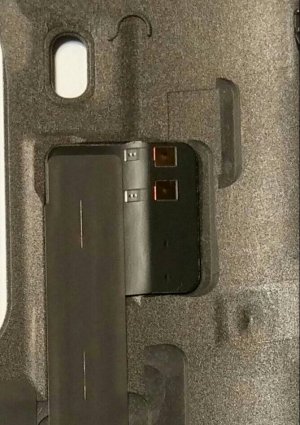

Here's a close up of the pins.

I did get my circle case from AT&T today. And it does have the 4 pins. (just PMA sadly).

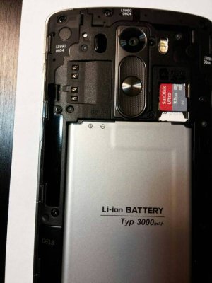

These are the 4 pins of the Sprint LG G3
The 4 pins are on every G3 (the phone itself)
There are 2pin backs and 4 pin
The 2 pin backs are for NFC
The 4 pin backs are for NFC & Wireless Charging.
The base 4 pins (phone itself) are there so you can purchase a back cover with 4 pins.

Yes, all LG G3's have four pins on the back of the phone, but they have two different pin layouts.
Some have all four close together, others have the four pins spaced out more. You should check to see if the replacement battery cover you buy is Qi compatible, and if it has the four pin layout which matches your internal pins.

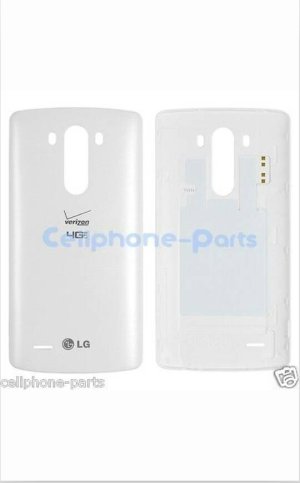

Do you know of any other confirmations on the other US carriers? I plan on getting a Qi back-plate for my Verizon G3.
Qi charging plate with VZW logo, go also has no carrier logo. uploadfromtaptalk1405442793670.jpg
